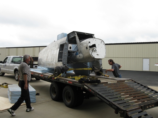

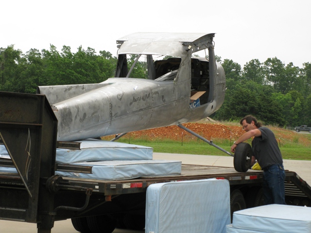

Originally Posted by Zachary_Watts
Well, I'm back from my preliminary hunt for corrosion
I'm semi relieved that you injected the word "preliminary", Zack, as I can caution you that a cursory peek in the bilges or through the wing tips like this most often times doesn't come close to revealing what's taking place in the deep abyss of the air frame.
Club members Sandy Newfang, Wayne Westerman and yours truly learned about corrosion in the school of hard knocks. Sandy had her wing removed, disassembled and rebuilt where Wayne and I threw our planes away.
Below are some pictures of mine the day the A&P school hauled the corpse away. frown
I wish we lived closer together so I could inspect it for you as I'm fond of what you're trying to do here and your desire of restoring the plane you learned to fly in....I really like your idea.
QUEENIE ON TRAILER 002.jpg QUEENIE ON TRAILER 003.jpg QUEENIE ON TRAILER 008.jpg
Absolutely Jim, I definitely have a few more rounds of detective work ahead of me.
Sorry to hear about You, Sandy, and Wayne! Those pictures are really, really sad. It's exact scene I'm hoping to prevent. What ended up being the areas that were affected on everyone's aircraft?

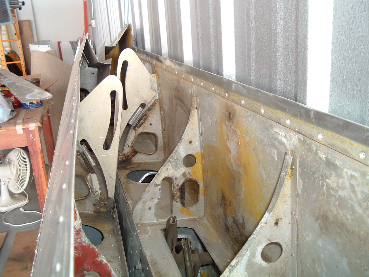

These are pictures of the corrosion inside the wings of the 152 that Jim donated to the A&P school.
