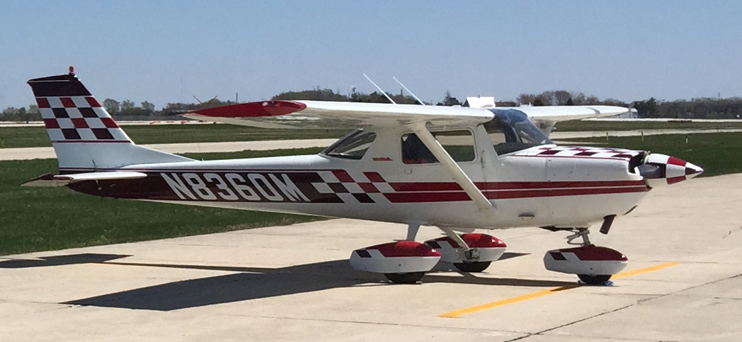

My next door hangar neighbor has a 150/150 Aerobat. It is about the most gorgeous airplane I have ever seen, a real creampuff with a fantastic quality paint job, and very well equipped. This is the only photo I have of it, which is a heavy crop and doesn't do it justice. The reason I mention it here is he has told me he is thinking about selling it to buy a Cirrus. If he firms up those plans, I will let the group here know.

That is sweet! I'll bet it will $20k over my budget. I need to be under $25 total.
That does look sharp though!
Is it still a aerobatic with the 150 upgrade?
