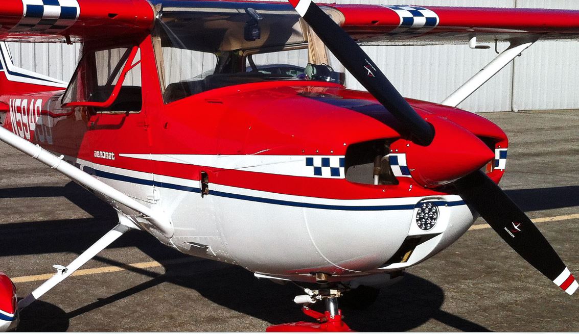

Mine was never a flight school abused plane, it was privately owned. However, 15 years out in the California sun faded it into an "uglybat". Nothing time and (lots) of money couldn't fix
