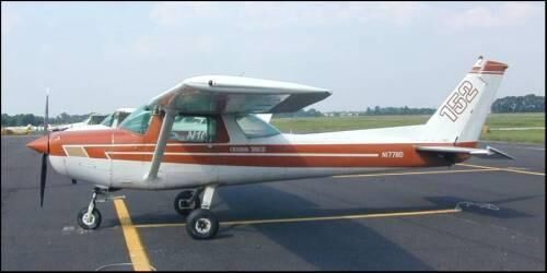

I believe you stand corrected.
My first 152, a 1978 model that I bought in 1984, had the small N number and paint was original.
Sierra (another '78 model) had the 12" so both sizes were being used back then.

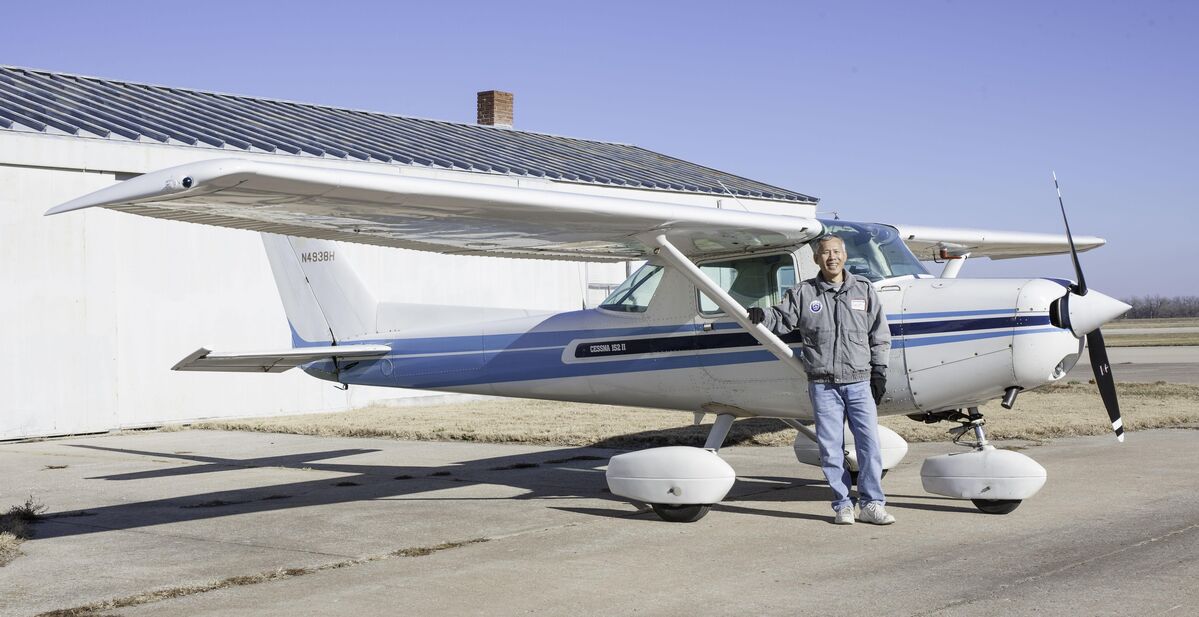

Yup, you got it wrong. My former '80 152 (built in Nov 1979) has the smaller N-number.
